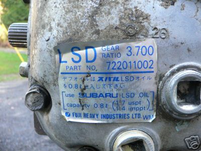

Decker_Forester Posted March 15, 2005 Share Posted March 15, 2005 The Subaru R160 LSD differential is this the right LSD for my 99 forester s auto???? Ben Link to comment Share on other sites More sharing options...
GLCraig Posted March 15, 2005 Share Posted March 15, 2005 nope that one has the 3.70 grear ratio and you're forester needs a 4.444 gear ratio. Link to comment Share on other sites More sharing options...
mudrat79 Posted March 15, 2005 Share Posted March 15, 2005 You can however convert it to work with your 4:444 gears in the rear diff though..... Do a search for LSD conversions in the Archives..... Link to comment Share on other sites More sharing options...

baccaruda Posted February 25, 2009 Share Posted February 25, 2009 an 83 GL wagon has a 3.9 ratio. The 3.9 gear can be put on that LSD to make it a 3.9. To make it a 4.11 or 4.44, the center section has to be modified to accept the larger bolts that the 4.11 and 4.44 gear require. Link to comment Share on other sites More sharing options...
thermalsurfing1 Posted February 25, 2009 Share Posted February 25, 2009 this is what i found for sale Subaru R160 rear differentials gear ratio 3.54 Both viscus LSD. so it will work in my 83 with some mods ? Link to comment Share on other sites More sharing options...
