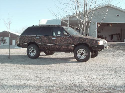

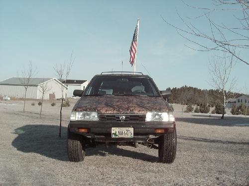

Tcat55371 Posted March 21, 2005 Share Posted March 21, 2005 If you can see it Link to comment Share on other sites More sharing options...
mcbrat Posted March 21, 2005 Share Posted March 21, 2005 looks good! Link to comment Share on other sites More sharing options...
pyromanic Posted March 21, 2005 Share Posted March 21, 2005 If you can see it Love that paint job! How did you do that? PYro Link to comment Share on other sites More sharing options...
Tcat55371 Posted March 21, 2005 Author Share Posted March 21, 2005 It's not paint. It's a 4'x5' vinyl sheet and you put it on like wallpaper. You can peel it off and the paint is good under it. On mine it's holding the rust together. lol My neighbor sells and installs the stuff and we needed a car to test it on when he first go it. Been on there a year now and I have had to fix spots here and there but it's pretty tough. Makes it thru the car washes ok. Here is a link to the stuff if you really want to see more about it: http://www.camoclad.com/ Link to comment Share on other sites More sharing options...
archemitis Posted March 21, 2005 Share Posted March 21, 2005 looks good, didnt take you long at all lifted and 6 lugged! threres a buncha offroad events this year in minnesota, and im afraid this might be the last real summer for offroading in minnesota. public land is being taken away from us since they are recatagorizing all of the ORV trails. either way, you gotta get it muddy, and possibly lost in the woods =] Link to comment Share on other sites More sharing options...
Tcat55371 Posted March 21, 2005 Author Share Posted March 21, 2005 Toyota 4runner rims 235x75'15 tires and rims Had to modify the trans tunnel to keep the shifter in 1st,3rd and 5th. Also had to do the console in the car Link to comment Share on other sites More sharing options...
Tcat55371 Posted March 21, 2005 Author Share Posted March 21, 2005 Yeah I drilled the lugs and that was pretty easy. Tac welded the front lugs where the reset is on the hub to get them to sit level. I screwed up and drilled them to 9/16 instead of 14mm. Took the rear drums to the neighbors mill to get them the right size sense I couldn't weld the pot metal. Had one frame nut break loose so I had to cut a hole in the floor to get at it and put a nut on it. Other then that it was pretty easy. Had it done on Saturday but the bike show yesterday took my whole day. Oh and I thought it was under powered before. lol Bet I could out run it for a block unless I start out in low range. Run 1st and 2nd and then shift back to 2wheel. Kinda like having another gear. lol Link to comment Share on other sites More sharing options...
