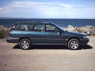

Mike W Posted August 4, 2005 Share Posted August 4, 2005 I got mine done a week ago but haven't had time to post about it. I used KYB struts for a '97 Outback and springs and mounts from a '92 AWD Legacy. In the picture the car appears to be sitting level but that's with a bunch of gear in the back. Un-loaded the rear sits about an inch taller than the front. I'll probably swap the front springs for some just a little taller to make the car sit level. The rear struts were very close or possibly touching the body of the car, so I did a bit of BFHammerology to be sure I didn't have any rubbing. The sway bars were slightly difficult to reconnect but other than that the installation was a breeze. Link to comment Share on other sites More sharing options...
