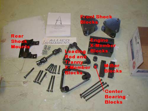

FirstSubaruGLwagon Posted September 28, 2005 Share Posted September 28, 2005 DrKrazy said: TA-DA! Couple questions...2 rear shock mounts ...................check 2 triangular mushtash bar blocks....check 2 engine blocks...........................check 2 frount strut blocks....................check 2 other blocks.....? 1. Are the transmission mount lowering blocks? 2. Are there blocks for the other rear mounts on the mustash (crossmember) bar? 3. Are there blocks to go betwine the transverse link (control arm) and leading rod or betwine the leading rod mount and the body? 4. Are there center bearing mount lowering blocks? if not , Is the Differential angle important to U-joint life? Thanks Dave Link to comment Share on other sites More sharing options...
Shadyirishmen Posted September 28, 2005 Author Share Posted September 28, 2005 1. Are the transmission mount lowering blocks? There the triangular pieces. 2. Are there blocks for the other rear mounts on the mustash (crossmember) bar? Only the mounts for the rear mustache bar. 3. Are there blocks to go betwine the transverse link (control arm) and leading rod or betwine the leading rod mount and the body? Engine cradle blocks are the big squares, and the front strut extensions. 4. Are there center bearing mount lowering blocks? if not , Is the Differential angle important to U-joint life? There are center bearing mount lowering blocks. Thanks Dave Link to comment Share on other sites More sharing options...
Numbchux Posted September 28, 2005 Share Posted September 28, 2005 FirstSubaruGLwagon said: Couple questions...2 rear shock mounts ...................check 2 triangular mushtash bar blocks....check 2 engine blocks...........................check 2 frount strut blocks....................check 2 other blocks.....? 1. Are the transmission mount lowering blocks? 2. Are there blocks for the other rear mounts on the mustash (crossmember) bar? 3. Are there blocks to go betwine the transverse link (control arm) and leading rod or betwine the leading rod mount and the body? 4. Are there center bearing mount lowering blocks? if not , Is the Differential angle important to U-joint life? Thanks Dave Maybe this will answer your question... the control arms are attached to the engine crossmember, so yes, they are lowered too Link to comment Share on other sites More sharing options...

FirstSubaruGLwagon Posted September 29, 2005 Share Posted September 29, 2005 kingbobdole said: ok... mine sooo do not that the letters on them, but! I noticed that they are kinda triangularly shaped, but more kinda arrowish... Can anyone give me an idea which way goes towards the front of the car? I'mm make sure that they are that direction and if the camber still looks bad, I'll swap them. The camber on one side right now looks good, but the other side is pretty bad........ \-----| .......Maybe someone can put arrows on DrKrazy's pic of "to the front of car" and "engine is over there"Thanks guys... Hey shady whats the word on my 5th wheels... and what about the shifter protector blocks? Chux my engine fan almost touches the skid plate in front and the rad... in fact when I accelerate hard, you can hear the fan eating its self...... If I pitch it back, wont it always be hitting... my pitch rod is about 2" too short now it seems Does this offset diagram look close? Right and Left sides should be mirror images. right? Link to comment Share on other sites More sharing options...

FirstSubaruGLwagon Posted September 30, 2005 Share Posted September 30, 2005 kingbobdole said: can anyone make me a pic of the top and how its supposed to face? That other pic is very helpful firstsubaruglwagon thanks! Now I just need the top so I can get these things in correctly. Well This is a guess I haven't recieved my kit yet so I could be wrong. However they should look something like this... or maybe..... wich ever puts the botom bolt holes closer toward the engine or wheel well Link to comment Share on other sites More sharing options...
