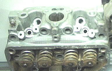

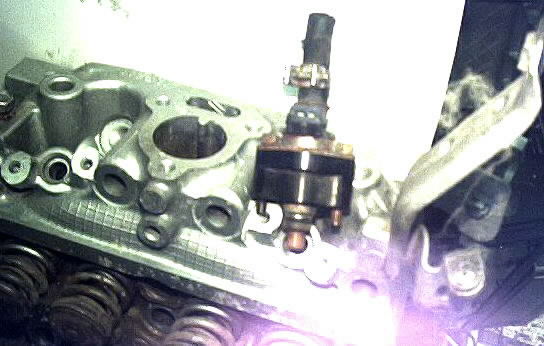

Ross Posted September 12, 2005 Author Share Posted September 12, 2005 Here are some pics of the cleaned block/heads/pistons etc... http://www.ultimatesubaru.org/photos/data/500/8111IMG_1299_Medium_.JPG http://www.ultimatesubaru.org/photos/data/500/8111IMG_1301_Medium_.JPG http://www.ultimatesubaru.org/photos/data/500/8111IMG_1298_Medium_.JPG http://www.ultimatesubaru.org/photos/data/500/8111IMG_1297_Medium_.JPG Link to comment Share on other sites More sharing options...

Snowman Posted September 12, 2005 Share Posted September 12, 2005 Here are some pics of the cleaned block/heads/pistons etc... http://www.ultimatesubaru.org/photos/data/500/8111IMG_1299_Medium_.JPG http://www.ultimatesubaru.org/photos/data/500/8111IMG_1301_Medium_.JPG http://www.ultimatesubaru.org/photos/data/500/8111IMG_1298_Medium_.JPG http://www.ultimatesubaru.org/photos/data/500/8111IMG_1297_Medium_.JPG Engine porn! Seriously though, that's gonna be a sweet motor when it's finished. Link to comment Share on other sites More sharing options...

froggymike Posted September 12, 2005 Share Posted September 12, 2005 Here are some pics of the cleaned block/heads/pistons etc... http://www.ultimatesubaru.org/photos/data/500/8111IMG_1299_Medium_.JPG http://www.ultimatesubaru.org/photos/data/500/8111IMG_1301_Medium_.JPG http://www.ultimatesubaru.org/photos/data/500/8111IMG_1298_Medium_.JPG http://www.ultimatesubaru.org/photos/data/500/8111IMG_1297_Medium_.JPG Pretty!!! Link to comment Share on other sites More sharing options...
