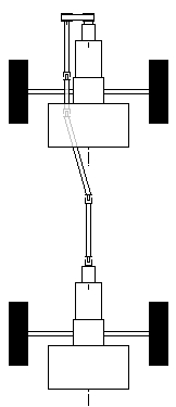

Tbird Man Posted November 18, 2005 Share Posted November 18, 2005 I just got an Idea, how about a twin EJ wagon, a EJ22na up front and in back with the rearmost 4wd output rerouted to the front. you would probiblt need to lock one of the center diffs but that way you would have a twin engine AWD and woulden't have to worry about the drivetrain bolwing up as you have a variable center diff. then you could have a center axle disconnect, put one tranny in 1st and the other in R and do a flatspin (very impressive a twin motor Tibron did that and won "Best Burnout" in a mag comp) Link to comment Share on other sites More sharing options...
Subarian Posted November 19, 2005 Share Posted November 19, 2005 That "Best Burnout" would have to come with an incredible cash prize to make it worthwhile! Link to comment Share on other sites More sharing options...
archemitis Posted November 19, 2005 Share Posted November 19, 2005 this thread is still at the top? have i mentioned my er27 makes as much horse power as alot of 80s v8s? 150 hp. if you want more, get a different Subaru engine cast iron blocks are for suckers. Link to comment Share on other sites More sharing options...
Tbird Man Posted November 23, 2005 Share Posted November 23, 2005 That "Best Burnout" would have to come with an incredible cash prize to make it worthwhile! See below \/ \/ \/ Link to comment Share on other sites More sharing options...
