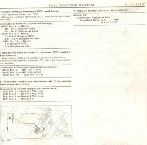

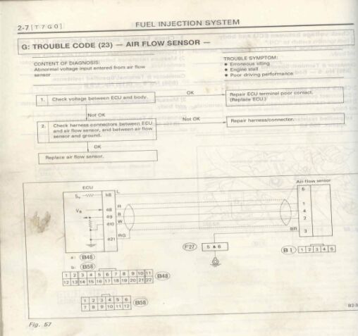

subpennyman Posted September 16, 2005 Author Share Posted September 16, 2005 Anyone know what the resistance should be on the MAF Connector- 3 pins B,C,D A is not used. Link to comment Share on other sites More sharing options...
royboy159 Posted September 16, 2005 Share Posted September 16, 2005 No voltage on any of the 3 pins and wires going to the MAF (Motor running) Connector unplugged when measurements taken.Hey Sub---If there aren't any harness continuity issues then you definitely have ECU failure. The voltages readings should be as follows: Link to comment Share on other sites More sharing options...
subpennyman Posted September 17, 2005 Author Share Posted September 17, 2005 Thanks a whole bunch Royboy!!! (What book did you dig that out of? )I'll be able to atleast take a MAF resistance reading in the morning before my wife drives down to McMinnville, OR at 9am for our sons homecoming football game! His last year there! Their team was top dogs last year!! I would go but I am taking our 2 children on a Train ride around the Port of Tacoma Rail Yard. Its an annual thing that Tacomarail.com puts on as part of Our Maritime Fest! The Kids are sooo excited! Link to comment Share on other sites More sharing options...

subpennyman Posted September 22, 2005 Author Share Posted September 22, 2005 It's time for some good NEws!!! When resistance from MAF connector to ECU was not the same as junk yard sample-went searching for 3 wires from MAF to ECU at the ECU! Found 1 connector partially unplugged. Properly seated connector so that it locked and rechecked resistance from MAF to ECU. Had resistance between all 3 wires pins BCD;at junk yard only had resistance between 2 pins BC. Immediately unplugged battery for 15 minutes to clear codes-restarted and let run for 2 minutes- NO LIGHTS!!! Motor did not want to stall out- in fact it idled purrrrr-fectly- with no small hiccups either!! YES! I am going to let my wife drive it tomorrow and I will check them again in the evening. I suspect that connector was unplugged during my Dec-Jan 04-05 nightmare with the engine! Thanks for you faithful help here! Link to comment Share on other sites More sharing options...
royboy159 Posted September 22, 2005 Share Posted September 22, 2005 Hey Sub---That is great news! I'd bet you can even do a D-mode check now (the greens connected). I think Glen would agree that the simplest problem can present the most perplexing picture. Now we've become the "more knowledgeable" guys I mentioned in a previous post. Link to comment Share on other sites More sharing options...
