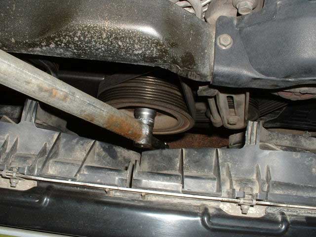

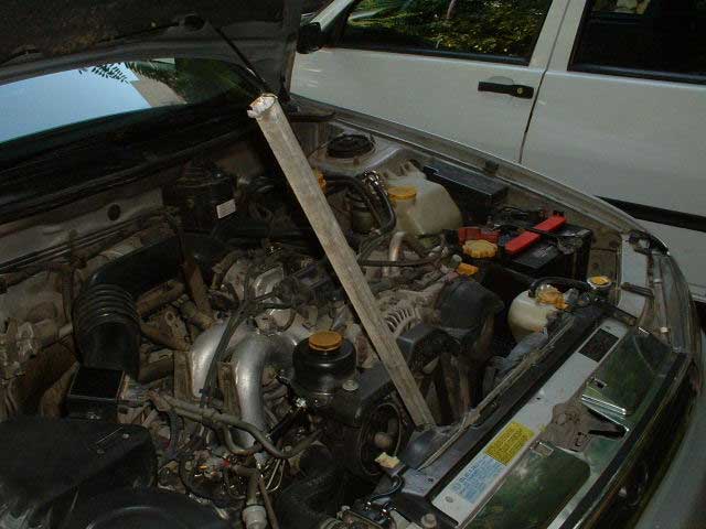

itzik93 Posted September 8, 2005 Share Posted September 8, 2005 first, remove the intake assembly, then below that on the bell housing will be a little rubber cober for the timing marks basically. pop that off nd wedge a flat head screw driver between the teeth of the ring gear and hte block. basically, stick the screw drver in there and start to turn the bolt, eventually it will catch and lock it in place./ Use a STRONG screw driver. Done that before and also used braker bar to remove the bolt (piece of cake) Here's 2 pictures during the proccess. Link to comment Share on other sites More sharing options...
