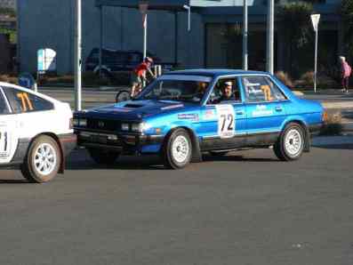

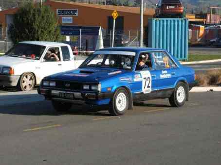

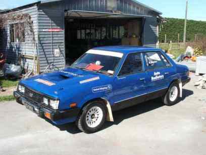

EA82Turbo Posted September 13, 2005 Share Posted September 13, 2005 Had a big crash at a rally event. Check out the fix up job I did in 3 weeks or after work and weekends! Before and after pics attached. (I Hope???) refer to:http://www.ultimatesubaru.org/forum/showthread.php?t=39749 for crash pictures. Hayden Link to comment Share on other sites More sharing options...

EA82Turbo Posted September 13, 2005 Author Share Posted September 13, 2005 Yep got some higher quality photos, I'll put them in my gallery. Paint is good aye? its 2005 wrx blue. Engine is a EA82 Turbo with a little work done. Running 10 psi with intercooler, oil cooler, 3 core radiator, custom extractors, removed power steering and air con, modified turbo for less lag (hits at about 2500rpm but flatens at about 6000rpm), external wastegate, 3" exhaust with no cat and high flow 3" exhaust, twin trumpet blow off value, K&N cone filter. Should have around 170hp, seems to be about as fast as other cars around this hp. But have beaten many 300hp + cars! Hoping to fit a Legacy rear Viscous LSD I have, but just doing some research to see if its possible. Current running two single spinner diffs, rank! not much good in a drift! Link to comment Share on other sites More sharing options...
