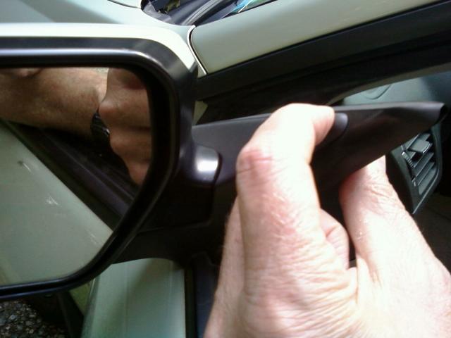

brus brother Posted March 27, 2005 Share Posted March 27, 2005 The apparent "fix" is to pinch the top of the triangle of the gusset while the window is down. The apparent cause of the problem is that since the window is without a frame on the door, when opening or closing the door, grabbing or pushing the glass is the culprit. It is a rather long lever arm that you create and you supposedly can twist the gusset sufficiently to cause the distortion. Also, if you find yourself in a tight parking situation and have to squeeze your body past the door, the effect is the same in distorting the gusset. Link to comment Share on other sites More sharing options...

brus brother Posted July 22, 2006 Share Posted July 22, 2006 If you invision the trangular shaped piece that the mirror is attached to, like a sail, pinch the top portion of the trangle. Remember the forces that initially distort this piece are from the window being man handled. Your objective is to reverse this action... sorry no picture yet. This sounds quite interesting but i don't really get the position to be pinched (1st gen legacy). Maybe somebody can post a photo? I don't want to tear up my window rubber by punching wrong. Link to comment Share on other sites More sharing options...

brus brother Posted July 23, 2006 Share Posted July 23, 2006 Open window, open door, pinch the top of the plastic triangle slightly, drive around and pinch more if needed. Do you mean that plastic triangular shaped piece or the rubber. If I push on the plastic thing during driving the noise reduces, has something to do with it. Link to comment Share on other sites More sharing options...

brus brother Posted July 17, 2012 Share Posted July 17, 2012 (edited) Still no pictures? Click on thumbnail. This is on an 05 but you get the idea. Edited July 17, 2012 by brus brother 1 Link to comment Share on other sites More sharing options...
