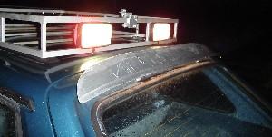

soobmater Posted November 12, 2005 Share Posted November 12, 2005 heres mine, on a mudrat roof rack and... Link to comment Share on other sites More sharing options...
