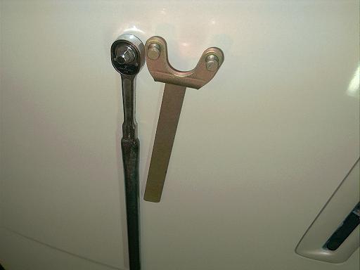

svxpert Posted November 18, 2005 Share Posted November 18, 2005 or these... (the correct tools) Link to comment Share on other sites More sharing options...
