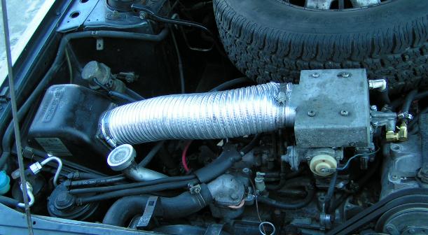

Subarian Posted December 12, 2005 Share Posted December 12, 2005 I can send a pic tonight, but I can describe it to you now. I took an air box off of a fuel injected subaru, made a bonnet out of sheet aluminum for my carb (mine's a Weber 32/36) and ran flexible metal dryer duct between them. I originally had used NAPA duct hose, but it kept disintegrating. Quote Link to comment Share on other sites More sharing options...

Subarian Posted December 16, 2005 Share Posted December 16, 2005 OK, here's my pic. Quote Link to comment Share on other sites More sharing options...
