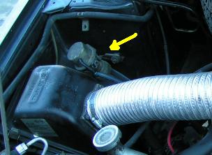

Subarian Posted December 16, 2005 Share Posted December 16, 2005 Did you ever figure out the problem? I took a pic of my anti-backfire valve. It's not in the original location, because I'm using an air filter box from a fuel injected motor. Normally it would sit right where the filter box is. Link to comment Share on other sites More sharing options...
