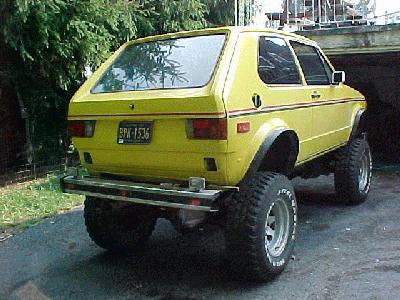

LiftedHatchSubie Posted January 12, 2006 Author Share Posted January 12, 2006 Both my cars have EA81s...hope I can find something to put the second engine, 4 speed trans, and complete running gear in. If I can't find another Subaru then I got my eyes on a VW Rabbit I'd like to try a conversion on....guess if push comes to shove then I might sell the extra but don't really want to do that unless have to. Link to comment Share on other sites More sharing options...
beauregaardhooligan Posted January 12, 2006 Share Posted January 12, 2006 LiftedHatchSubie said: I got my eyes on a VW Rabbit I'd like to try a conversion on.... Hmmm, a HiLoSubaRabbit? I *like* it! Link to comment Share on other sites More sharing options...
LiftedHatchSubie Posted January 13, 2006 Author Share Posted January 13, 2006 beauregaardhooligan said: Hmmm, a HiLoSubaRabbit?I *like* it! If I can find a picture of the 4x4 Rabbit that inspired me I'll post it here...looks pretty cool. Link to comment Share on other sites More sharing options...
LiftedHatchSubie Posted January 13, 2006 Author Share Posted January 13, 2006 LiftedHatchSubie said: If I can find a picture of the 4x4 Rabbit that inspired me I'll post it here...looks pretty cool. http://www.p3racing.net/vw/rabbit/REAR.JPG http://www.p3racing.net/vw/rabbit/Rabbit0001.jpg "The frame of the cj5 had to be stretched 10" and the firewall cut back 8"... other than problems with the steering column lining up right there really wasn't much work..." Link to comment Share on other sites More sharing options...
