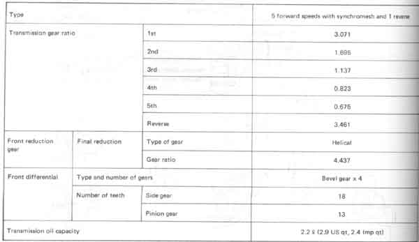

I had a new motor put into the justy and nice cute car i need to put a few pics up. Thing i didnt know at 3500 rpm is 70mph is the transmissions in those that low of a gear? Am i missing something i called the dealer and they where clueless and the book i have only showes how to break one down.. thanks guys.. glade i found this site..
