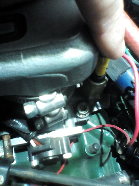

Step-a-toe Posted September 24, 2020 Share Posted September 24, 2020 (edited) Idle air control Valve Sort of have two with that function and you have blocked the first one off being the jigger on the thermostat Your second is on the dizzy side at the back of TB next to the screw you removed and cleaned. Some years had a two wire solenoid, one being for an earth. Pictured is my single wire unit. These really only increase revs a little to cope with load when AC is on. I don't think these turned on under power steering pump load. I use mine just for a faster idle on start up in colder months below 5°C with dedicated propane Impco fuel system. Just read the rest of your post The one a post describes as being under or behind PS pump is likely for the spider inlet as these deleted the thermostat mounted cold starting bypass valve. Have we discussed fuel pressure and injector cleanliness? Timing? You have covered: egr valve trans vac line idle air adjust screw fast idle control solenoid cold start air bypass on thermostat Pretty much it except the vac line from front of throttle to distributor vac advance can. Every one of these I have had have not held vacuum and inturn won't retard timing on boost. With propane air mix in my inlet I used to blow a little charge into the distributor body, match ( no pun yet) this with a little spark that was supposed to hop from rotor button to terminal inside, I didn't get boost , I got BOOM ! Took five months to resolve, marshmallow valve springs got initial blame Edited September 24, 2020 by Step-a-toe Link to comment Share on other sites More sharing options...
