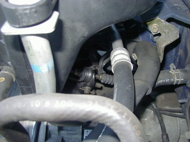

Setright Posted February 13, 2006 Share Posted February 13, 2006 Well, the Impreza clutch is quite "progressive" which means it does have long travel, and 100% engagement comes high up the pedal travel. But it does sound like your cable is too tight. Try adjusting it. Two bolts on the end of the cable, a 12mm for actuall adjustment and a 10mm for locking it. Loosen them, back off the 10mm two full rotations, and then back off the 12mm until they lock together again. Here's a photo - worth a thousand words apparently http://img.photobucket.com/albums/v684/Setright/clutchfork.jpg Adjustement is right in the center of the photo. The pedal should not feel dead when it's on the floor, but spring back a little bit. Link to comment Share on other sites More sharing options...
