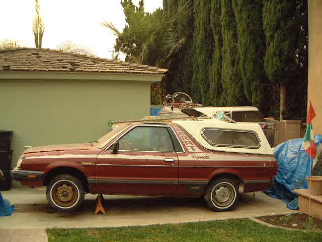

brat1709 Posted October 25, 2003 Author Share Posted October 25, 2003 Atten electryc_ monk- Any wireing color diagram would be greatly appreciated. Atten Mcbrat: Still working on the Turbo Brat. Its going to be a project. Very rusty. I'm currently dissassembling the Turbo brat, very slowly, so I won't miss any detailes. I purchased a black 1984 Subaru, and have spoken with the state smog referee. I've been told its OK to ulilize all the turbo parts onto the CA brat, and all modifications will be excepted, as long as it was a dealer option for the year. Both are 84's so I shouldn't have a problem. Will probably need the boards assistace in the near future for turbo connection. I've also just located a Japanese E-81T, and there going to let me have it for $550. Its going to be a difficult task, but I'm willing to do the trasplant , for the joy of driving a very neat toy. Will keep you informed as to the status. Just started tearing into the rusty brat 2 wks ago, so I'm kind of behind schedual. Did have a question for you tho' Mcbrat. I noticed the graphics on the side of the regular brats for sale, but no one has said anything about the Turbo Graphics. The Graphics appear to be intact on this model. How does one go about reproducing the graphics? Or is anyone out there offering them. Attached is a picture of the intact graphics on side, for turbo. Hugo/ So. CA Link to comment Share on other sites More sharing options...
