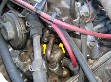

The easiest way on an EA82 is to block the exhaust port before it gets into the EGR. Subaru made it incredibly simple. Find the elbow that goes from your passenger side head to the intake manifold. You'll find it under a small elbow-shaped heat sheild. There are two bolts that connect the elbow to the manifold (arrows in picture). Put a piece of tin from a soup can behind that, and there's no exhaust flow to the intake or the EGR valve.
