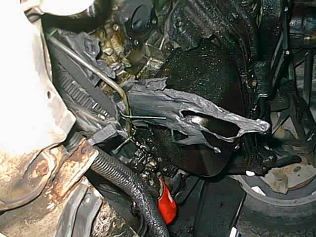

subiemech85 Posted March 16, 2006 Share Posted March 16, 2006 that's right it melted real good I had already removed the outside front covers just turn your head to the left and take a look Link to comment Share on other sites More sharing options...
waimaks Posted March 16, 2006 Share Posted March 16, 2006 EWha? HOW did that happen? Link to comment Share on other sites More sharing options...
Subieguy Posted March 16, 2006 Share Posted March 16, 2006 In order to get the engine that hot there has got to be some kind of damage to it:eek: Link to comment Share on other sites More sharing options...
GLCraig Posted March 16, 2006 Share Posted March 16, 2006 I'm afraid you got yourself a boat anchor bolted to your transmission. Link to comment Share on other sites More sharing options...
[HTi]Johnson Posted March 16, 2006 Share Posted March 16, 2006 Turbo? Did you get your crossover pipe too hot? If it's a turbo, it could mean your cat is clogged. I think I spy a downpipe in the pic. Oh did you blow an exhaust gasket? Link to comment Share on other sites More sharing options...
calebz Posted March 16, 2006 Share Posted March 16, 2006 I'm afraid you got yourself a boat anchor bolted to your transmission. Rubbish. In the 10+ EA82 motors I have had. Ranging from 60 to 200k+, every single one has had belt covers with at least some level of meltage. I do admit that pic is a little extreme, but it could be as simple as a leaky exhaust gasket. Link to comment Share on other sites More sharing options...
