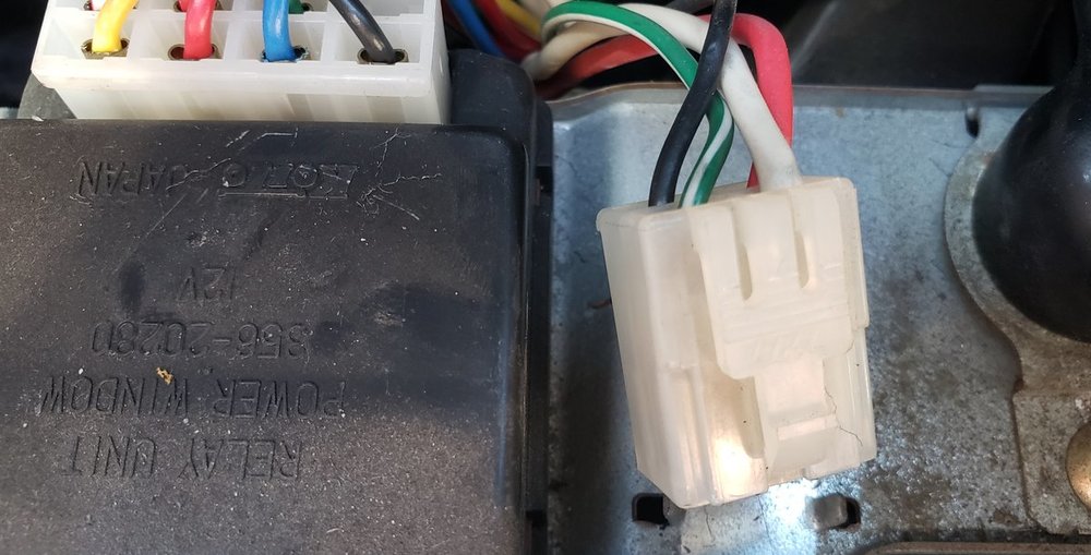

Checkerboard Comet Posted July 25, 2020 Share Posted July 25, 2020 I was hoping you could tell me what is what based on this picture? What is: RED GREEN/WHITE STRIPE BLACK WHITE Quote Link to comment Share on other sites More sharing options...
