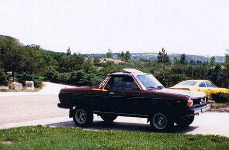

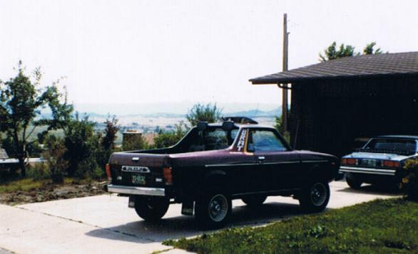

Your on the right track, the front is a simple body lift, the rear: get a whole rear drivetrain assembly(torsion tube, axles, hubs, shocks,I reccomed ea82 2wd rear shocks and a custom mount) out of an 80-84 wagon or 82-87 brat and mock it up to your gutted rear end(keep your moustach bar. you should be able to picture what needs to be fabbed. it makes the rear track about 3" wider overall(note factory mudflaps). here are my two non explanatory pictures (both of these have custom 3" mudrat lifts) Oh and I'm able to go way higher in the rear with torsion tube on this brat(note axles angles), but then the rake is rediculous (need 4" of lift up front) and I loose too much flex
hey that green wagon is the "pickle" I owned it for 4 years and wheeled the holy crap out of it, though sadly Mudrat and I hauled it to the junk yard about a week ago :(. I think I'm going to build another one ppretty soon. Anyway if you have Q's about the lift PM me.
