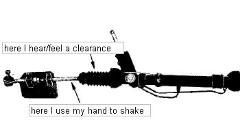

bella Posted March 31, 2006 Share Posted March 31, 2006 As I mentioned in attached image I have a clearance on my driver side tie rod. So is not ball joint from my tie rod end and from what I now is no way to use adjusting screw because it cannot be clamped(is maximum clamped).:mad::mad: So, what can I do now. From what I now, in the driver side is no bushing or something like in passenger side. Please help... Thank you all. Link to comment Share on other sites More sharing options...
dxrflyboy Posted March 31, 2006 Share Posted March 31, 2006 Your inner tie rod is worn out. Link to comment Share on other sites More sharing options...
bella Posted March 31, 2006 Author Share Posted March 31, 2006 dxrflyboy said: Your inner tie rod is worn out. So I MUST buy a new Steering box? Link to comment Share on other sites More sharing options...

dxrflyboy Posted March 31, 2006 Share Posted March 31, 2006 Inner tie rods can be changed without replacing the rack. You will need an inner tie rod tool to replace it. Link to comment Share on other sites More sharing options...
bella Posted March 31, 2006 Author Share Posted March 31, 2006 dxrflyboy said: Inner tie rods can be changed without replacing the rack. You will need an inner tie rod tool to replace it. Can you PLEASE give me few details......there is on marketplace a repair kit or what?? I have a steering box picture bu I don't now what is the inner tie rod.... Thanks a million. Link to comment Share on other sites More sharing options...
idosubaru Posted March 31, 2006 Share Posted March 31, 2006 where your arrow points and says "here i use my hand to shake"...that's the inner tie rod. it connects to the rack underneath the boot. here is a picture of a set on ebay: http://cgi.ebay.com/ebaymotors/Subaru-XT-Coupe-Turbo-85-87-Front-OEM-Inner-Tie-Rod-Set_W0QQitemZ8043773358QQcategoryZ33593QQrdZ1QQcmdZViewItem you'll notice the threaded ends that extend beyond the boot. the other end is the part "inside" the boot where you seem to have some play. Link to comment Share on other sites More sharing options...
bella Posted March 31, 2006 Author Share Posted March 31, 2006 grossgary said: where your arrow points and says "here i use my hand to shake"...that's the inner tie rod. it connects to the rack underneath the boot. here is a picture of a set on ebay: http://cgi.ebay.com/ebaymotors/Subaru-XT-Coupe-Turbo-85-87-Front-OEM-Inner-Tie-Rod-Set_W0QQitemZ8043773358QQcategoryZ33593QQrdZ1QQcmdZViewItem you'll notice the threaded ends that extend beyond the boot. the other end is the part "inside" the boot where you seem to have some play. Man, you really are a Master:). Thank you so much and all guys for replyes and HOPE that will be the problem. Thank you all for your time. Link to comment Share on other sites More sharing options...
bella Posted March 31, 2006 Author Share Posted March 31, 2006 One more question......inner tie rod can be replaced without dismount steering rack?? 10x:) Link to comment Share on other sites More sharing options...
idosubaru Posted March 31, 2006 Share Posted March 31, 2006 i highly doubt you'd have to remove the steering rack to remove the inner tie rod. i've never done it, but i've removed/installed a number of steering racks. i would be very surprised to hear differently. should be a fairly straight forward process. the outer tie rod is only attached by one bolt, so once you remove that it will dangle down freely and you should have access to the inner rod and boot as needed. Link to comment Share on other sites More sharing options...
bella Posted March 31, 2006 Author Share Posted March 31, 2006 grossgary said: i highly doubt you'd have to remove the steering rack to remove the inner tie rod. i've never done it, but i've removed/installed a number of steering racks. i would be very surprised to hear differently. should be a fairly straight forward process. the outer tie rod is only attached by one bolt, so once you remove that it will dangle down freely and you should have access to the inner rod and boot as needed. Thank you:) Link to comment Share on other sites More sharing options...
dxrflyboy Posted April 1, 2006 Share Posted April 1, 2006 It's been a number of years since I wrenched on an older gen Sube, but they typically have more working room around the ends of the rack than most cars. The inner tie rod tool I mentioned in a previous post slides over the tie rod after the outer end and rack boot have been removed. The appropriate sized insert to fit the flats on the rack end is locked into the end of the tool, and a 1/2" breaker bar is inserted at the other to unscrew the tie rod from the rack. If there is sufficient working room, the tie rod can be removed/replaced with an open end/adjustable wrench. Link to comment Share on other sites More sharing options...
