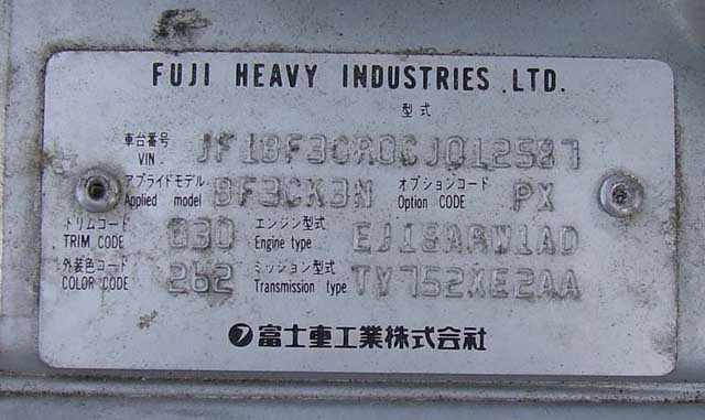

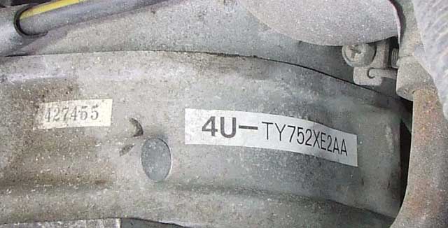

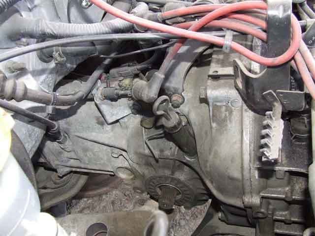

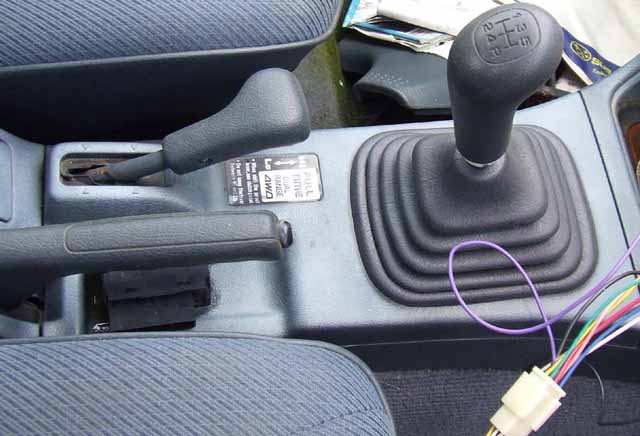

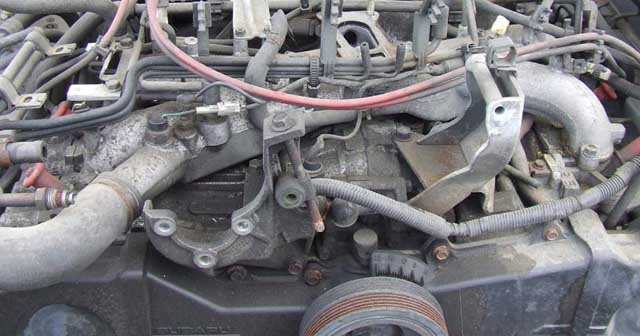

mikie Posted April 6, 2006 Share Posted April 6, 2006 JDM legacy. Model code BF3CK3N, trans code TY752XE2AA. Engine is EJ18. Found in wreckers yard. This appears to be a full time 4wd box with hi/lo ratio and 4.11 final drive... this got me interested so i went back and took photos. It also has a carbed inlet manifold, which may be adaptable onto an Ej22, and a distributor that runs of the rh bank, the EJ22 has a blank off plate over the hole. Ideal for simple EJ conversion. Both had already been sold of this wagon. This trans would be ideal for an EJ conversion into an EA-powered vehicle... but further more i wonder if the gearsets would interchange with EA d/r boxes, they have exactly the same ratios i believe, same clutch input shaft spline. You could make a 4.11 final drive EA box. or put the lockable centre diff from an ea or s/r ej box in it. or put any EJ 4.44 cw + pinion in it. match it with a 4.11 or 4.44 viscous rear diff. If the reduction is only 1.2:1 then would the 1.596:1 EA reduction gears fit ? hmmmm. If i had some spare time and too much money id buy it just to find out. the bad news however, is, its in new zealand... thats why ive posted the model codes, might be helpful to someone out there. Link to comment Share on other sites More sharing options...

75subie Posted April 6, 2006 Share Posted April 6, 2006 dual range ej from the factory? thats friggen sweet:D i just want the complete center console out of that thing (to save on shipping of course) then just use a ea82 d/r:D Link to comment Share on other sites More sharing options...

baccaruda Posted April 7, 2006 Share Posted April 7, 2006 oh man. if you buy it to me and smuggle it to me in the mail piece by piece I swear I'll pay you back. seriously, I wonder if us having the VIN on hand would be helpful for finding more of these? would you be able to get the VIN for The Good Of The Board? Link to comment Share on other sites More sharing options...

samo Posted April 7, 2006 Share Posted April 7, 2006 Keep in mind that the low range reduction is more like an RX D/R than the typical GL D/R we're used to. Gearing is already an issue for us with the GL transmission and it's 1.596:1. Even with lower diff ratios, I think gearing will be a major issue. Also, keep in mind that the center diff on EJ transmissions is limited slip, not locked (well, nonexistant to be accurate) of the GL D/R. This, I would imagine, could lead to traction issues, although the EJ transmissions do have a fairly aggressive center diff. It's a neat find, but 1. good luck getting one in the States, and even more to the point, if you're building an offroader, why not use the EA transmission? Link to comment Share on other sites More sharing options...

mikie Posted April 9, 2006 Author Share Posted April 9, 2006 Shipping would be stupidly expensive i imagine. There must be some legacies over there somewhere like this. I admit its the first and only one ive seen in NZ thou. We miss out on much cool stuff over here that you folks get a heap of, but we do have JDM cars in oversupply. baccaruda, what do you mean by VIN ? The picture of the vehicle id plate is what i would have called the VIN, the chassis code has the relevant info for the model, at least BF3 indicates a EJ18 4wd station wagon. Now for the mix n match part.... The other legacy i saw recently had a push button 4wd locking centre diff. There are plenty of them with 4.444 front and rear diffs. The lo ratio gears from a EA box *might* fit into this EJ box. It bolts to the EJ22. The potential product would be very cool. Thats what i was driving at. Link to comment Share on other sites More sharing options...
