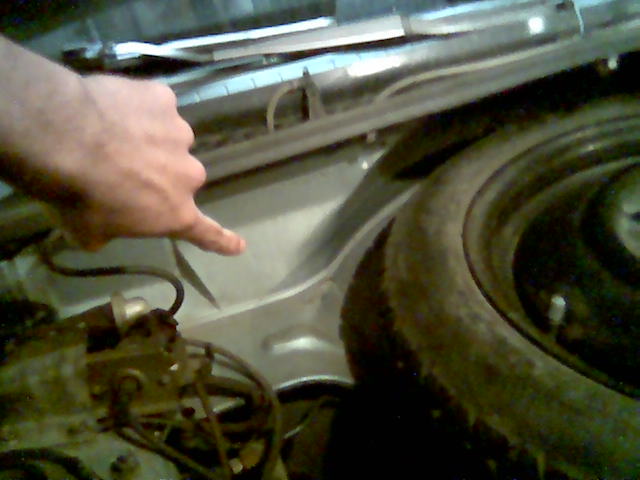

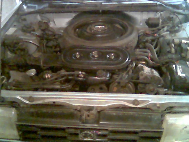

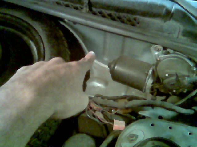

mmm....chocolate chip cookies :slobber: . i'm pretty sure that its a hose. the back panel (where the dash is mounted) is called the fire wall. if you look at the engine bay from the front of the car, the "wall" behind the spare tire is the fire wall. sure hope this helps (hope i get those cookies too :grin: ). let me know if it helps or not that way i can post a pic for you. well might as well add those pics to help you out. these are the two up close angles and the full view of the firewall from the front of the car.

I'm on my way out to my car right now. I get firewall now. I'm going to look around and see what I see and then I'll be back here to report what I see.
