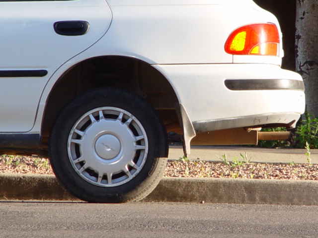

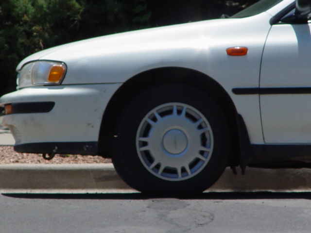

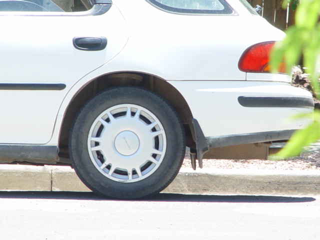

superu Posted June 20, 2006 Share Posted June 20, 2006 So here's a couple images of before and after. '93 IMP on '98 FOR struts and springs... As you can see, i gained like 4 inches in the back and a couple in front... How can i bring down the back some so its not all jacked up '70's musscle car-style? I'm thinking of either dropping in legacy springs or the stock IMP springs, but would like you guys' opinions... 1 Link to comment Share on other sites More sharing options...

ezapar Posted June 20, 2006 Share Posted June 20, 2006 superu said: So here's a couple images of before and after.'93 IMP on '98 FOR struts and springs... As you can see, i gained like 4 inches in the back and a couple in front... How can i bring down the back some so its not all jacked up '70's musscle car-style? I'm thinking of either dropping in legacy springs or the stock IMP springs, but would like you guys' opinions... My car does the same thing, but I like it. Before I got the OB springs to go with the OB struts, I had to use my stock OBS springs. I wasnt' happy. Without spring compressors, I was able to install the springs on teh struts and tighten the nut on top by hand. Yeah, that loose. The OB strut has an inch and a half more up travel. I would recommend looking into a regular legacy wagon rear spring. Might be a happy medium. EZ Link to comment Share on other sites More sharing options...

superu Posted June 20, 2006 Share Posted June 20, 2006 these pix show the point best... before: http://www.ultimatesubaru.org/forum/attachment.php?attachmentid=3981&d=1150779235 after: http://www.ultimatesubaru.org/forum/attachment.php?attachmentid=3980&d=1150778988 Link to comment Share on other sites More sharing options...
ezapar Posted June 20, 2006 Share Posted June 20, 2006 Quote The wheel as swung forward and is too close to the fender, and i am not a fan of the chizle/doorstop look.. Here's a different before and after. I've done some trimming on the green car, doesn't look too "hacked" to me. Still looks close, but they would rub severely on a stock OBS. Link to comment Share on other sites More sharing options...
superu Posted June 20, 2006 Share Posted June 20, 2006 Zapar said: Here's a different before and after. I've done some trimming on the green car, doesn't look too "hacked" to me. Still looks close, but they would rub severely on a stock OBS. Right on, those are certaily larger than I would go on this rig. Its not aven an OBS, just plain '93 IMP L... Maybe OBS wells are larger? Anyway, did you have the clunking issue at the rear upper mounts (as did Andy and a couple others) when you completed the job? I'm thinking legacy springs (as you alluded to) and a washer or two to tighten the shock stud at the mount... THanks for your beta Eric (I think that's you I'm terrible conecting names to screen names... Link to comment Share on other sites More sharing options...

superu Posted June 21, 2006 Share Posted June 21, 2006 Andyjo said: Maybe i should add another washer... that'd explain the clunking... d'oh! Oh yeah... what's with the rear end there... breaking any axles? Silly aint it? That's forester struts and springs straight into an Impreza... front's fine, back's kinda high (for what I'm looking for) Link to comment Share on other sites More sharing options...
MountainBiker Posted June 21, 2006 Share Posted June 21, 2006 superu said: Silly aint it? That's forester struts and springs straight into an Impreza... front's fine, back's kinda high (for what I'm looking for) What year Forester struts? The earlier models up to '02 have shorter rear struts, while the length of the fronts hasn't changed. Link to comment Share on other sites More sharing options...
superu Posted June 21, 2006 Share Posted June 21, 2006 MountainBiker said: What year Forester struts? The earlier models up to '02 have shorter rear struts, while the length of the fronts hasn't changed. Those were '98 forester struts and springs. I think the strut length plus the forester spring gave it like 4 inches. I'm going to swap out the springs from forester to legacy or back to the original IMP springs, but in doing so I'm going to look closely at teh shock studs in comparison to see how to get rid of the clunking... Link to comment Share on other sites More sharing options...
