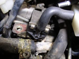

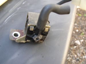

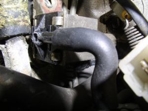

ok im working on this ea82t motor and have found a sensor that is brokeni dont know what to call it but i have a few pics its right beside the throttle body and coolent line going to turbo its in between the two ill try to post pics.
That is either the EGR or Purge control solenoid. Can't remember which is which. I have neither on my wagon anymore.
Someone recently found a solenoid from a honda that is sturdier and within spec.
cool, would this explain why the car is so slow? its like the turbo isnt even spooling.what does the selonoid do exactly? can it be bypassed at all? and one more question is there a vacume routing diagram floting around on the boards anywhare for the ea82t. thanks agian for the help
That solenoid controls when your charcoal canister is purged of fuel vapors. Other than a possible smallish vacuum leak (depending on what side of the valve snapped off), it should not have any effect on your performance.
