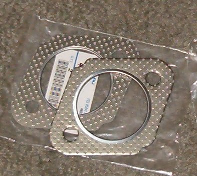

mikeshoup Posted May 22, 2006 Share Posted May 22, 2006 Definitely get OEM exhaust gaskets. There's a HUGE difference in quality. I was amazed when I compared the aftermarket gaskets I had sitting in my trunk to the OEM ones... Mucho Bettero. This is the OEM gaskets. If you know what the aftermarket gaskets look like, you can tell by the looks these are muco bettero Quote Link to comment Share on other sites More sharing options...
Meeky Moose Posted May 22, 2006 Share Posted May 22, 2006 to get the same oem gasket aftermarket, you have to get the ea82 turbo gaskets.. the ea82T gaskets will fit any ea81 or ea82.. they are not those cheap paper ones.. they're just like oem... Quote Link to comment Share on other sites More sharing options...
