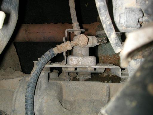

nipper Posted June 5, 2006 Share Posted June 5, 2006 I have a pic and i have no idea how to post it. Can i email it to somone and have them post it (yes im a clutz at this stuff). I have not seen this car in person but the pic looks like a block of some kind with the hyd clutch lines passing through it. It is mounted on the side of the tranny. It has a bleed valve. I want to say hill holder but i dont see any brake lines in the pic. Also i dont know what a hyd clutch hillholder looks like. nipper Link to comment Share on other sites More sharing options...

idosubaru Posted June 5, 2006 Share Posted June 5, 2006 here it is.... Link to comment Share on other sites More sharing options...
Legacy777 Posted June 5, 2006 Share Posted June 5, 2006 That part is a clutch damper. There should be a line running from the clutch master cylinder to the damper, and then to the clutch slave cylinder. As to what exactly it does..other then "damp" something....I'm really not sure. I did not install the damper when I did my AWD & 5MT swap, and I don't really see an issue to not having it on there. Link to comment Share on other sites More sharing options...
Dr. RX Posted June 5, 2006 Share Posted June 5, 2006 So what model and year is this part on. I have a complete hydrualic clutch setup from a 92 Turbo Legacy and there isn't anything that that there. I have a hydrualic clutch on the 96 WRX and there is nothing that that there either. Link to comment Share on other sites More sharing options...
OB99W Posted June 5, 2006 Share Posted June 5, 2006 That part is a clutch damper.[...]As to what exactly it does..other then "damp" something....I'm really not sure. [...] As far as I know, clutch dampers are typically used for two possible reasons: 1) To minimize potential damage to the trans should the driver rev the hell out of the engine and pop the clutch; damping would tend to smoke the clutch a bit more, but that's probably better than stripped gear teeth or broken shafts. 2) To help minimize clutch shudder if there's a tendency towards that happening. Link to comment Share on other sites More sharing options...
cookie Posted June 5, 2006 Share Posted June 5, 2006 BMW often uses restirctions or clutch delay valves also. If you have a type of car that folks tend to beat they can prevent serious damage. BMW hot rodders often remove them. Link to comment Share on other sites More sharing options...
nipper Posted June 5, 2006 Author Share Posted June 5, 2006 So what model and year is this part on. I have a complete hydrualic clutch setup from a 92 Turbo Legacy and there isn't anything that that there. I have a hydrualic clutch on the 96 WRX and there is nothing that that there either. sorry thought i posted that, its a 98 Legacy wagon. Haynes makes no mention of the silly thing. nipper Link to comment Share on other sites More sharing options...
Legacy777 Posted June 6, 2006 Share Posted June 6, 2006 So what model and year is this part on. I have a complete hydrualic clutch setup from a 92 Turbo Legacy and there isn't anything that that there. I have a hydrualic clutch on the 96 WRX and there is nothing that that there either. I believe they were only on the 91 turbos, if my memory serves me correct. Link to comment Share on other sites More sharing options...
nipper Posted June 6, 2006 Author Share Posted June 6, 2006 i checked subaruparts.com and they actually show it existing on the 98 obw (or at least available) nipper Link to comment Share on other sites More sharing options...
Legacy777 Posted June 6, 2006 Share Posted June 6, 2006 I'm sure it may exist on some of the newer subarus, however on the first gen legacies 90-94....I believe it only came on the 91 turbo model. Link to comment Share on other sites More sharing options...
nipper Posted June 6, 2006 Author Share Posted June 6, 2006 Can anyone with a 1998 leagcay or ouback with a manual pup thier hood and see if they have this part too? The haynes book says nothing about it. i go to subaruparts.com and its listed on the 1998 clutch system. i have never seen it come up here. nipper Link to comment Share on other sites More sharing options...
fastwgn286 Posted June 6, 2006 Share Posted June 6, 2006 97 ok? ill check it tomorrow.... Link to comment Share on other sites More sharing options...
nipper Posted June 6, 2006 Author Share Posted June 6, 2006 97 ok? ill check it tomorrow.... Thats fine, it shows it listed there too. nipper Link to comment Share on other sites More sharing options...
fastwgn286 Posted June 6, 2006 Share Posted June 6, 2006 is it right underneath the clutch cylinder? if so, 97 outbacks have 'em. Link to comment Share on other sites More sharing options...
hankosolder2 Posted June 7, 2006 Share Posted June 7, 2006 Can anyone with a 1998 leagcay or ouback with a manual pup thier hood and see if they have this part too? The haynes book says nothing about it. i go to subaruparts.com and its listed on the 1998 clutch system. i have never seen it come up here. nipper I have a '98 Legacy Outback 5mt...the master cylinder is connected directly through a hose to the slave cylinder- no delay valve. Production date on the car is 6/97. I know there were clutch changes made between '97 and '98; the '98 master cylinder costs about half as much as the '97. cheers, Nathan Link to comment Share on other sites More sharing options...
