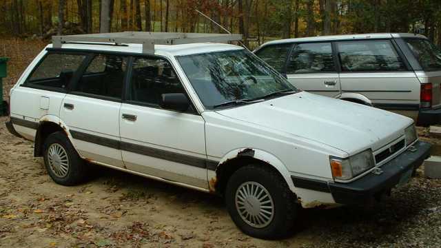

DaveT Posted November 1, 2006 Share Posted November 1, 2006 Here are a couple pics of my roof rack. I have had 300-400 lbs on it. For long items I put an X with ratchet straps on the front, down to the tow hooks. The front part detaches with 6 pins. Quote Link to comment Share on other sites More sharing options...

DaveT Posted November 3, 2006 Share Posted November 3, 2006 I'm wondering if there are going to be strong sheer forces goin' on around corners & stuff ... That is what I found the X nescisary for. The weight is supported by the 6" wide aluminum plates setting in the gutters and the 2 front verticals. The front - back inertia is handled by 8 bolts into the special stock roof rack nuts. With the X, I can grab the rack at the front and shake the entire car side to side without moving the rack relative to the car. Quote Link to comment Share on other sites More sharing options...
