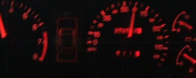

jonas Posted July 12, 2006 Share Posted July 12, 2006 dash of an '84GL wagon. enjoy! Link to comment Share on other sites More sharing options...

jonas Posted July 12, 2006 Author Share Posted July 12, 2006 yeah, i'm quite pleased w/the results. i also made the heater and vent controls red also. Link to comment Share on other sites More sharing options...
Jerry DeMoss Posted July 12, 2006 Share Posted July 12, 2006 I am going to do that too!I was originally going to use blue,but red is alot easier on the eyes at night.Please tell us what you used?Red paint or is it colored bulbs?Did you use bulbs or L.E.D.'s ? Link to comment Share on other sites More sharing options...
jonas Posted July 12, 2006 Author Share Posted July 12, 2006 i used clear bulbs and a red magic marker. since i had to replace some burned out lights anyway i fingered i would try it out. i'm gonna do my dome and glove box lights too. if you have the amber lights don't worry about marking the yellow plastic with the red marker. it comes out fine. i also suggest replacing ALL the bulbs since you will have the dash cracked open anyways. those old bulbs are suprisingly brittle.... Link to comment Share on other sites More sharing options...

dragonfire Posted July 12, 2006 Share Posted July 12, 2006 i have red bulbs i got from advance auto. 4 bucks for 4 lights. the 194. i now have inverted tip blue led. got those from pep boys. the only thing i do not like about the blue, is that the needles do not show up as well. hhhmmm. how to fix that? :-\ cool dash lights man. Link to comment Share on other sites More sharing options...
