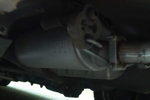

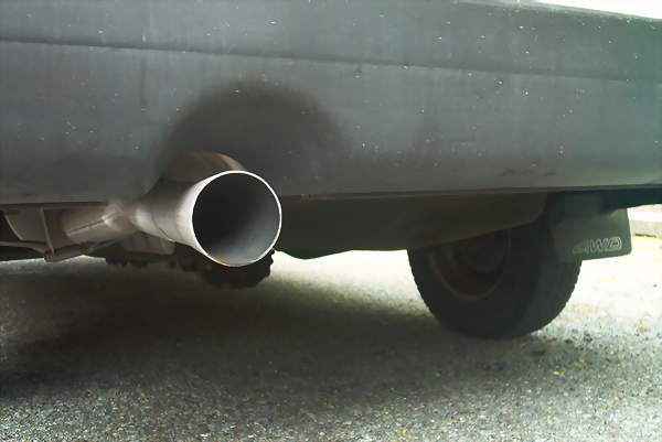

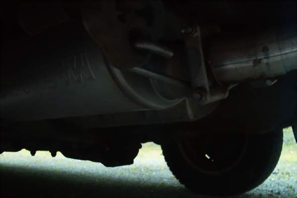

mummer43 Posted November 4, 2003 Share Posted November 4, 2003 I have a 91 Loyale and I replaced my stock muffler with a magnaflow muffler. It's round like the stock one and fits right where the stock one was. From what i remember, inlet/outlet is the same size as the stock piping or it may be a 1/2" bigger. It really doesn't matter. I had the mechanic add a nice flared piece of pipe to look like a tip. I don't remember where I got it, but I'll do a search. Here are some pics: Link to comment Share on other sites More sharing options...
mummer43 Posted November 4, 2003 Share Posted November 4, 2003 More pics... Link to comment Share on other sites More sharing options...

mummer43 Posted November 4, 2003 Share Posted November 4, 2003 Another one... Link to comment Share on other sites More sharing options...
mummer43 Posted November 4, 2003 Share Posted November 4, 2003 Another... Link to comment Share on other sites More sharing options...

mummer43 Posted November 4, 2003 Share Posted November 4, 2003 Last one. By the way, I think this was like $40... Link to comment Share on other sites More sharing options...
mummer43 Posted November 4, 2003 Share Posted November 4, 2003 When I first put it on, it was definately louder than stock, but not too loud. After I cut the airbox open it has gotten louder, but still sounds great. Link to comment Share on other sites More sharing options...

mummer43 Posted November 4, 2003 Share Posted November 4, 2003 Here's the Magnaflow website. The Muffler I got is the 6" round aluminized. It's definately the 2" inlet/outlet and I think it's offset/offset but don't qote me on that. It's the same as the stock muffler was. You can find them cheap online. Link to comment Share on other sites More sharing options...
