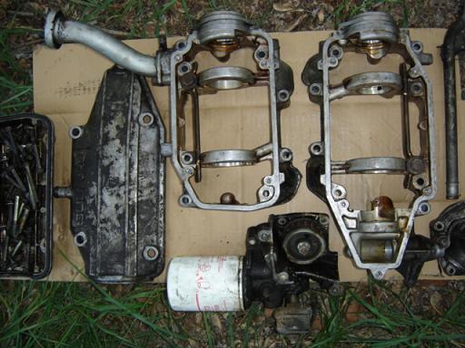

Special Fred Posted September 5, 2006 Author Share Posted September 5, 2006 you need mpfi heads a wiring harness and ecu at the very least Like these? Quote Link to comment Share on other sites More sharing options...
GeneralDisorder Posted September 5, 2006 Share Posted September 5, 2006 No - those are the cam towers. You need the MPFI heads, manifold, cams (you actually DON'T need the towers), ECU, Fuel pump, and complete engine and ECU wiring harness. GD Quote Link to comment Share on other sites More sharing options...
Special Fred Posted September 5, 2006 Author Share Posted September 5, 2006 No - those are the cam towers. You need the MPFI heads, manifold, cams (you actually DON'T need the towers), ECU, Fuel pump, and complete engine and ECU wiring harness. GD Oh, OK, I see. Thanks GD! So I can reuse my existing cam towers then? Will there be any piston-to-valve conflict with my existing short block? Quote Link to comment Share on other sites More sharing options...
