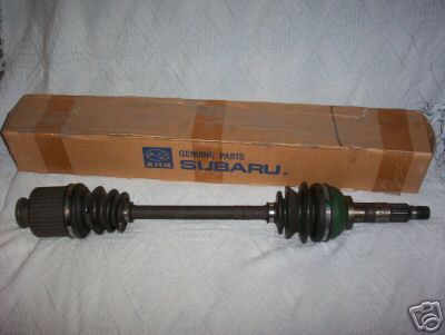

Davalos Posted October 13, 2006 Author Share Posted October 13, 2006 Okay, I'm about to crack open this axle ... and I think I may have goofed. I have a '90 Loyale MT2WD non-turbo. And this is the Axle I scored off of Ebay. Definitely 3 paddings on the shaft, and definitely 25 Splines inside there, according to the page Turbone gave. Here's the label off the box: The Manual and some peeps tell me it's for a Turbo only? But others tell me it's fine. If what I'm reading in the maual is correct, there is no such thing as a non-turbo with 25 splines on the inner sleeve, correct? My parts guy comes up with the exact same part number for both the 2wd and 4wd .. ugh! It's gonna really suck to have this thing pulled apart & dropped & not have the right part for 2 more days ... Link to comment Share on other sites More sharing options...
edrach Posted October 13, 2006 Share Posted October 13, 2006 25 splines is definitely for the turbo. It'll fit without any trouble until you drive off when it will shear off the roll pin and spin on the stub axle (been there, done that). All is not lost however, since I'm sure some turbo owner will buy it from you. Link to comment Share on other sites More sharing options...
Davalos Posted October 13, 2006 Author Share Posted October 13, 2006 Ok ... fair enough. Sucks, but it happens ... so I guess I have an OEM Axle for sale, lol. Now - looks like I'm shoppin' for some rebuilts ... Cardone and USA Industries both make rebuilts ... $65 bones a side. Any reason to (or NOT to) do both of them at the same time while I'm droppin' stuff? Link to comment Share on other sites More sharing options...
