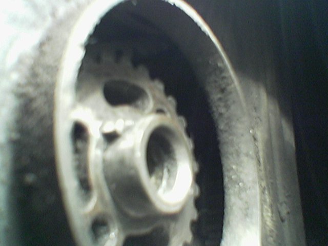

ericem Posted September 18, 2006 Author Share Posted September 18, 2006 AW!! im super PO'ed! look, heres some pics, its looks like the idiot from 2 years ago who did the timing belt did this, and he probably didnt torque it down. Ok well does it looks like the key is still alright? ANd i reinstall some new belts and the the pulley, now what about the thread, does it look right? Link to comment Share on other sites More sharing options...
xrturbo Posted September 18, 2006 Share Posted September 18, 2006 do you mean with a new pulley? i wouldn't put that one back on. you will find out when you get the new pulley if the keyway is ok. try to set the pulley in place by hand and make sure it goes flush and try to tuen it back and forth without the bolt. normally the threads don't get screwed up. Link to comment Share on other sites More sharing options...
ericem Posted September 18, 2006 Author Share Posted September 18, 2006 So from that pic ur saying the keyway is alright!!! IF SO HIP HIP HORRAY!!! and yes off course, i will buy a new pulley. Link to comment Share on other sites More sharing options...

xrturbo Posted September 18, 2006 Share Posted September 18, 2006 i normally use blue, it didnt look too bad. just do that little check i was talkin about, so that way you dont go through it again with your new pulley. Link to comment Share on other sites More sharing options...
ericem Posted September 18, 2006 Author Share Posted September 18, 2006 ok, thank alot man, so ur like 99 percent sure the key is alright? Tommorow ill pickup the new pulley, and belts. SO just when i put on the pulley, make sure the key grabs right? THen put the bolt and and smere blue locktite on the bolt, and torque it down good, right? ANd just jam the flywheel? WHere exactly do i jam it, and i really appreciate ur help, this is our only car in the family(at the moment). Link to comment Share on other sites More sharing options...

nipper Posted September 18, 2006 Share Posted September 18, 2006 DO use a torquewrench and properly torque the bolt down (70-80 2.2 and 90-100 ft lbs 2.5). Also inspect the front main seal and see if it is leaking or needs replacement, just in case. Then praise the subaru Gods that your keyway survived. You may need a new key too. nipper Link to comment Share on other sites More sharing options...
ericem Posted September 18, 2006 Author Share Posted September 18, 2006 DO use a torquewrench and properly torque the bolt down (70-80 2.2 and 90-100 ft lbs 2.5). Also inspect the front main seal and see if it is leaking or needs replacement, just in case. Then praise the subaru Gods that your keyway survived. You may need a new key too. nipper So i need a torque wrench ? Doh, new tool to buy, ok, and the front seals are perfect, and did u check out my pic off the key nipper? did it look right? Link to comment Share on other sites More sharing options...
nipper Posted September 18, 2006 Share Posted September 18, 2006 So i need a torque wrench ? Doh, new tool to buy, ok, and the front seals are perfect, and did u check out my pic off the key nipper? did it look right? i cant tell from the pics, they are too distorted. the worst case scenario if you dont want to go through the pain of replacng it, is you may have to clean it up a bit with a file. PS a beam type torque wrench is juat as good as a digital or a snaping torque wrench. This is really one of the most important bolts on the car. You have no idea how lucky you are that the keyway did not get mangled in the crank. nipper Link to comment Share on other sites More sharing options...
ericem Posted September 18, 2006 Author Share Posted September 18, 2006 ok, well tommorow ill take some better pics with my acual camera, then u tell me if i need a new key. but it definitly wasnt mangled from what i saw. Link to comment Share on other sites More sharing options...
