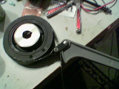

ericem Posted September 19, 2006 Author Share Posted September 19, 2006 please post a pic of the "thing that holds the pulley" This thing it has a handle and a rubber belt rated a 1300lb. and it put it around the pulley. Link to comment Share on other sites More sharing options...
nipper Posted September 19, 2006 Share Posted September 19, 2006 This thing it has a handle and a rubber belt rated a 1300lb. and it put it around the pulley. Ah yes the ol' pully holder thingy , otherwise known as a strap wrench. nipper Link to comment Share on other sites More sharing options...
