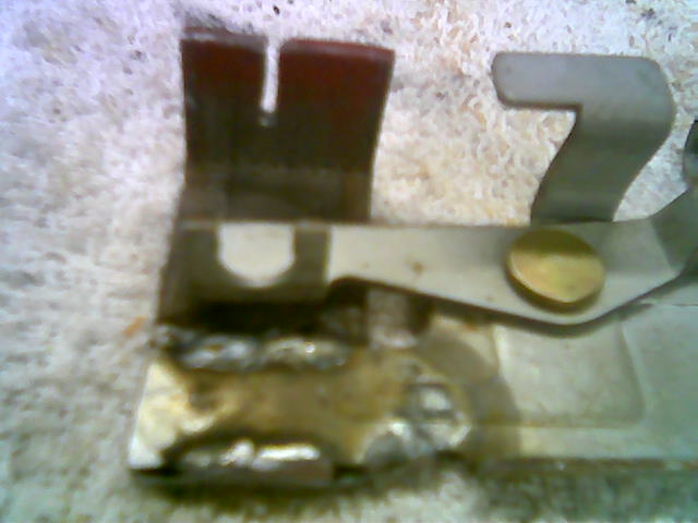

youareabus Posted October 2, 2006 Author Share Posted October 2, 2006 OK, this is how I fixed it. I cut the cable off passed the little crimped on fitting on the cable and pulled out the section continuing on to the trunk lock. Then I welded a little bracket I made onto the door pop bracket and slotted it for the cable. Now it's a pull cable and not a push to pop the gas door. I tried to get good pictures of it with the cable installed but it's too dark in the trunk, yes it was broke just where you said it was - the plastic ring broke off the end of the cable shield. I used it just as-is to clip into the arm and it works slick. Here's a pic of the bracket.(I think the pic will come up, this is the first one I have tried here. I attatched it under Additional options). Quote Link to comment Share on other sites More sharing options...
daeron Posted October 2, 2006 Share Posted October 2, 2006 ahh, I see.. to be honest, it never occurred to me to say stuff the trunk release, just rig it to run the gas door and be done with it. I prefer to keep stuff working, and hate HAVING to use my key to open the trunk... but I see youre point. I had a much easier time wire tying it together thanks to my handy access hole. ("big props" are in order to my man Oxidation for that one!! thanks bud!) Before i fixed it, you could just reach in the hole and grab the whole cable, and pull it to open the trunk.. now that doesnt work anymore, because before the outer insulation (gas door "cable") was sliding on the inner wire (trunklid "cable") and then ultimately just tugged the inner wire.. but now its all solid. obviously, though, if you dont mind using your key (and if it even occurs to you ) your solution is a bit simpler. Quote Link to comment Share on other sites More sharing options...
