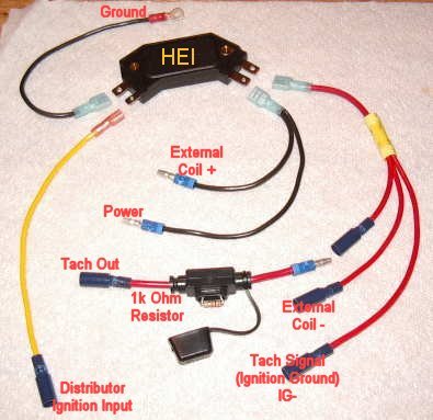

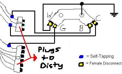

1slow_si Posted December 7, 2006 Author Share Posted December 7, 2006 Me too. Also, the coil bracket serves as a ground so I would make sure it's nice and clean and tightly attached. Thanks for the replies...I will try making a ground for the bracket and see if it helps. If not, I was looking around for a new ignitor and nobody sells them except for the stealership. They sell the coil, bracket with ignitor attached as a package and want $360 for it! I was going to get one from the junkyard and thought that if I did, it would be old and may not last. So, I was thinking about trying to use an ignition module from an early GM car. I have seen it done on many rotaries, probes and mx6's. Has anyone tried this? I'm not sure if the signal from the ecu will drive it. On the rotary it gets the signal directly from the magnet in the disty. Any thoughts? These are wiring diagrams I found for mazda's From what I've read, it should work. BTW The resistor is for the tach signal. Link to comment Share on other sites More sharing options...
Sister7 Posted December 7, 2006 Share Posted December 7, 2006 Personally, I would just stick to the JY unit (get a spare if you're worried about it). You should probably get one anyways to make sure that it is the culprit. I don't know much about them, but it seems possible to get the gain wrong on the amplifier if you're not careful. I'm not sure what consequenses that would have. If you go for the project, let me know if you need any wiring diagrams for the soob. Link to comment Share on other sites More sharing options...
GeneralDisorder Posted December 7, 2006 Share Posted December 7, 2006 SPFI uses an optical distributor that only the ECU will understand. The ECU signal to the ignitor might drive the GM HEI unit, but I'm not sure.... The ignitors are tough - they rarely fail unless overheated. GD Link to comment Share on other sites More sharing options...
john in KY Posted December 7, 2006 Share Posted December 7, 2006 I was thinking about trying to use an ignition module from an early GM car. I have seen it done on many rotaries, probes and mx6's. Has anyone tried this? I'm not sure if the signal from the ecu will drive it. On the rotary it gets the signal directly from the magnet in the disty. Any thoughts? Nice ignition upgrade but it won't work on a Subaru. Requires a magnetic pick-up type distributor. Link to comment Share on other sites More sharing options...
