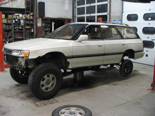

Subafreak Posted November 30, 2006 Author Share Posted November 30, 2006 Link to comment Share on other sites More sharing options...

Phizinza Posted November 30, 2006 Share Posted November 30, 2006 Did you make it so the front wheels sit that much further forwards, or is something not bolted on in those pics? Looks fun Link to comment Share on other sites More sharing options...

Subafreak Posted November 30, 2006 Author Share Posted November 30, 2006 Yeah we moved the whole subframe forward to make more room for the tires to turn. Kinda hard to remove the door frame. We did the same with the rear. Sticking to some 33 9.50 BFG at's for now becouse it's gonna be her daily driver this winter. Link to comment Share on other sites More sharing options...
