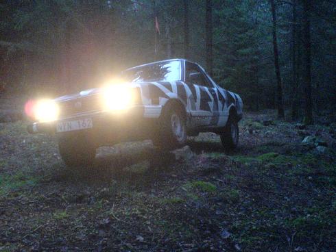

riverstream Posted December 6, 2006 Author Share Posted December 6, 2006 Ive been real lazy and my lift kit is not fabricated yet. The only thing ive done so far is some cutting in the front under the plastic bumper, heres a picture (bad mobile phone pic) with my car in my friends back yard. We were both surprised how the subaru could manage his back yard. Link to comment Share on other sites More sharing options...
