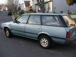

idosubaru Posted December 6, 2006 Share Posted December 6, 2006 trying to help a guy and his family out with a reliable soob. i'm looking at a 1986 4WD wagon. probably has a freaking carb which i've never worked on. i'll be installing all new timing belts, water pump, oil pump, seals, battery cables, etc.... but not knowing anything about the carb, what are the best options? are they fairly reliable? how expensive is a new carb, is that overkill? from the pic's can anyone verify it's a carb'ed EA82 and what 4WD manual transmission this 1986 would have? Link to comment Share on other sites More sharing options...
jeep5.9litre Posted December 6, 2006 Share Posted December 6, 2006 From the pic, looks to me like a carbed EA82 with a 5 speed D/R if its a manual tranny Link to comment Share on other sites More sharing options...
