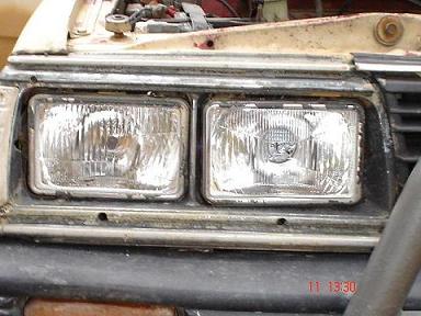

RavenTBK Posted January 5, 2007 Share Posted January 5, 2007 Oh my God! ... ... 700Watts output? ... I Really will Love to see a Pic of That Setup!. Could you Put here some Pics? I would post a bunch, however, its unrelated to the composite lamped EA82. I probably should've made that a bit more clear... this was done on an EA81, with the quad lamp setup. I'm unsure if the early ea82 quad lamp setup would swap into a loyale or not. As to how it looks, it looks completely stock. I've attached a close-up of what they look like. You can plainly see the Autopal logo, and H1 in the middle of the high beam lens. They're actually E-code for LHD countries, and not the RHD models that others try to get away with, causing dangerous glare for oncoming drivers. Either way, this technically doesnt apply to this thread, as its about the GL/Loyale. Well... Here in my Country, due to the Lack of Regulations, we can Obtain the 9104 Rally Bulbs, instead of the Standard 9004 ones. The main Difference `bout, is that the 9004 got Wider (Horizontally) Element, so Wider / Diffuser light is done by 9004. Instead, 9104 got Larger (Vertically) Element, so 9104 Bulbs Reach Twice the Distance with Twice Brightness, and more Clear Spot of Light. Interesting. I wasnt aware of the 9104's existence. Only thing on eBay I can find is one item, a stupid "crystal blue" bulb. How much do those things run you down there? I'm going to start looking into swapping out the lousy 9004s on my Bronco. /end threadjack Link to comment Share on other sites More sharing options...
