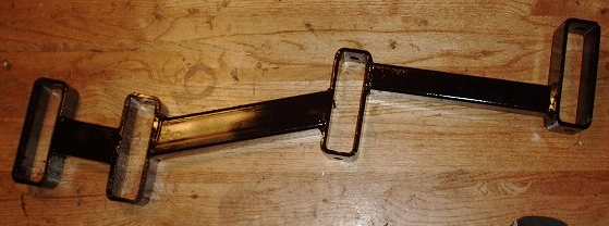

Reveeen Posted January 6, 2007 Share Posted January 6, 2007 You know, if you made a lift kit for your car, as seen here: http://www.subarubrat.com/PICS/frontlift4.JPG From: http://www.subarubrat.com/ You could dummy that rust up with just about anything and not worry one bit about lost strength. Link to comment Share on other sites More sharing options...
