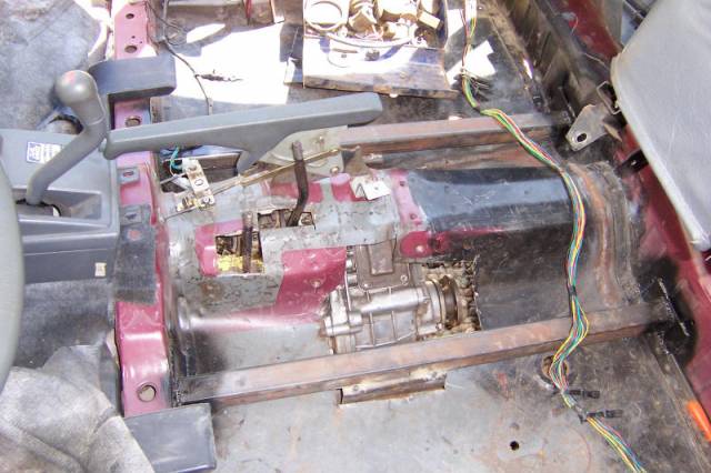

esh Posted January 17, 2007 Author Share Posted January 17, 2007 Scott in Bellingham said: check out this folder http://www.ultimatesubaru.org/photos/showgallery.php?ppuser=129&cat=500 thanks for the link. another question: what kind of t-case is that?Lada? Nissan? and what is the second shifter for? Link to comment Share on other sites More sharing options...
Numbchux Posted January 17, 2007 Share Posted January 17, 2007 esh said: thanks for the link. another question: what kind of t-case is that?Lada? Nissan? and what is the second shifter for? bushbasher started out with a lada one. I'm pretty sure he had problems with it and then went to a Nissan one instead. 2 shifters for 2 transfer cases. the subaru tcase is part of the transmission, so you still have the high-low range for that, and then the added tcase aswell. Link to comment Share on other sites More sharing options...

Hodaka Rider Posted January 18, 2007 Share Posted January 18, 2007 Numbchux said: bushbasher started out with a lada one. I'm pretty sure he had problems with it and then went to a Nissan one instead. 2 shifters for 2 transfer cases. the subaru tcase is part of the transmission, so you still have the high-low range for that, and then the added tcase aswell. IIRC, the problem that he had was a broken t-case mount, due to bashing the t-case into a rock (maybe a skid plate would have helped? dunno). In any case, you are not likely to find a Niva t-case anywhere south of the 49th parallel. There are a few, but not many. Link to comment Share on other sites More sharing options...

esh Posted January 19, 2007 Author Share Posted January 19, 2007 1) yes we do have few lada Niva around 2) two shifter on the lada T-case!!?? Link to comment Share on other sites More sharing options...
Hodaka Rider Posted January 19, 2007 Share Posted January 19, 2007 I haven't looked at a Niva for awhile, but . . . I think they are a full-time AWD box, with reduction in high range. (presumably because the engine/trans came from a car, and they had to compensate for bigger tires). It's possible the other lever is to lock the center diff. In fact, look here. If you click on "General Specs", it'll give you a .pdf: the high range is 1.2:1, low is 2.135:1. The "Niva Transmission" link gives you another .pdf showing the two levers: one for selecting hi/lo, the other for locking the center diff. Link to comment Share on other sites More sharing options...
