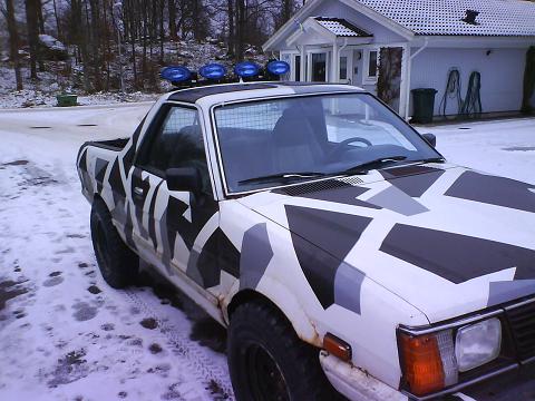

riverstream Posted February 12, 2007 Share Posted February 12, 2007 Heres a pic of my roof lights they are noname brand and cheap lights up as good as my 3Xhella rallyex 100 watt. The no names is 4x55 watt and the size is just perfect for the roll bar. Link to comment Share on other sites More sharing options...
