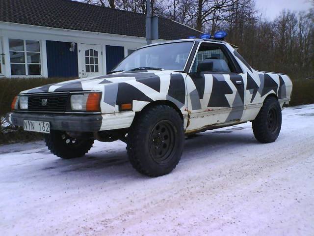

riverstream Posted February 12, 2007 Share Posted February 12, 2007 Heres pictures of my new tire setup on redrilled Opel frontera rims, the car is just on cranked suspension front and trimmed fenders. I guess i have to start to build my 2 inch liftkit soon, but first im just gonna fit new longer caster rods. Enjoy pic of the swedish rusty brat=) Link to comment Share on other sites More sharing options...

riverstream Posted February 13, 2007 Author Share Posted February 13, 2007 Thanks for the good comments about my paint, what do you guys think should i go for more fendertrimming or build myself liftblocks ( probably not legal here in sweden so i have to take of my lift every year for inspection time)??????? Link to comment Share on other sites More sharing options...
Spiffy Posted February 13, 2007 Share Posted February 13, 2007 looks cool but there doesn't seem to be any room for suspension travel... definately need the bit of lift for that big ol' tires... --Spiffy Link to comment Share on other sites More sharing options...
Phizinza Posted February 13, 2007 Share Posted February 13, 2007 You coud cut your fenders out really big, as in, all the way round. Or is that what you ment. Putting another inch on those caster/radius rods is a good idea. A lift kit isn't gonna do much different to cutting your fenders out. Because the exhaust and prop will still make your car have low clearance (well, not low, but not any better.) If you don't mind cutting them out a fit and maybe fitting some rubber flairing, then I'd say cut... Looks great by the way. Link to comment Share on other sites More sharing options...
Rollie715 Posted February 14, 2007 Share Posted February 14, 2007 I've always liked the look of huge tires on a "lowrider". I'd cut out the fenders more and stay with the bigger tires. As for clearance underneath, you will still gain the amount the tires have lifted the car even without a body or suspension lift. A 4" taller tire will gain you 2" more of clearance. Nice rig. Rollie Link to comment Share on other sites More sharing options...
riverstream Posted February 14, 2007 Author Share Posted February 14, 2007 Thanks for your opinions guys think it will be major fender cutting season on my brat soon becouse i dont mind cutting and make some new fender flares. Really like the look on it whitout lift blocks just need to fix my spare rods and put them on now. Link to comment Share on other sites More sharing options...

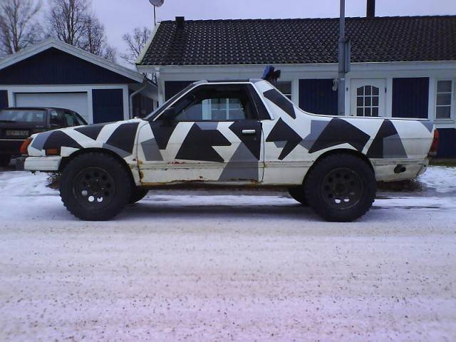

riverstream Posted February 19, 2007 Author Share Posted February 19, 2007 Just came home from the garage and this is what ive done today: and the whole car as it is for now, next step is fixing my radius rods and some small cutting in the back. Link to comment Share on other sites More sharing options...
