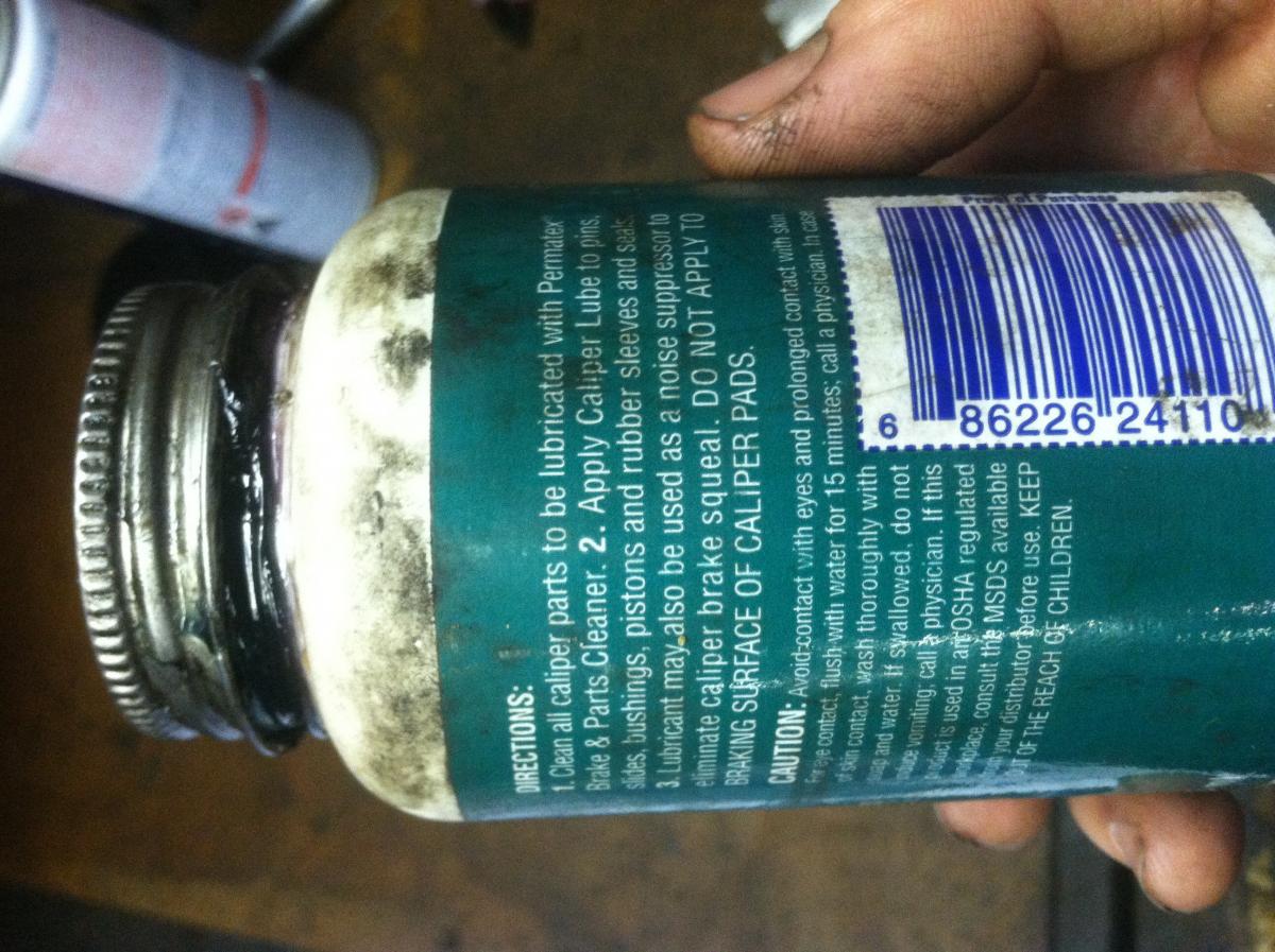

Fairtax4me Posted October 1, 2015 Share Posted October 1, 2015 Picture below of the label on the bottle I use at work almost every day. I think I slapped some pads in my 96 about a year ago and I don't remember if it had the rubber bushings or not. But I've done tons of other cars that do have them and really haven't noticed any issues. Quote Link to comment Share on other sites More sharing options...
1 Lucky Texan Posted October 1, 2015 Share Posted October 1, 2015 wow! they added the damn rubber restriction after that bottle was made I guess! (or changed the formula but kept the 24110 part number???) crazy. Quote Link to comment Share on other sites More sharing options...
