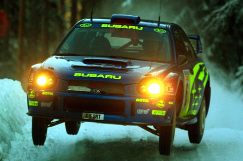

Virrdog Posted September 27, 2007 Share Posted September 27, 2007 The only other thing to watch for when going as narrow as possible is the load bearing capabilities of the tire itself. Other than that, the skinnier the better... IIRC, these are 155's or something along those lines. Quote Link to comment Share on other sites More sharing options...
