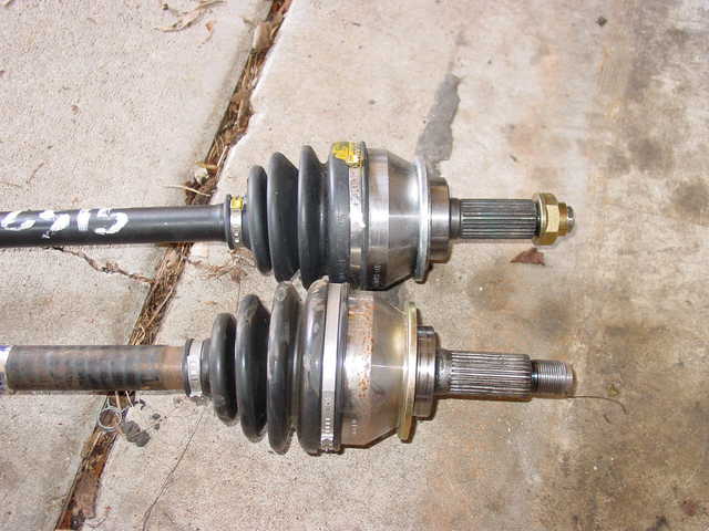

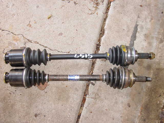

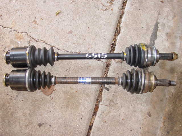

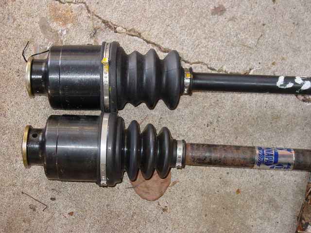

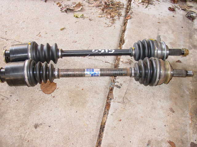

yarikoptic Posted May 13, 2007 Author Share Posted May 13, 2007 Here are the pictures from pearlm30 Imho -- NAPA's one has simply deeper sitted axle within the SFJ outer race so the rubber boot is not stressed at all and positioned per instructions within the grove on the axle. non-NAPA's one clearly stretched the boot -- look at the 2nd rubber boot 'circle' (sorry can't find a word to use). Such 'longer' assembly might be benefitial and remove the noise since it pushes axle stub inside differential... I wonder if I should let some air get into my boots while the car is lifteed and they are stretched so they behave this way.... Link to comment Share on other sites More sharing options...
idosubaru Posted May 13, 2007 Share Posted May 13, 2007 I brought brand new axles from NAPA autoparts hoping to cure my vibration problem from 25 to 30 mph. But they made it worst. Then I thought it could be the driveshaft(prop shaft), brought a used one, still not good. Decided to just bite the bullet and get rebuild axles from CV axle.com. I compared the both axles and NAPA is about 1 inch shorter:mad: . I think that why NAPA axles vibrate. It could be the wrong application, who knows. So I now have cv axle.com axles in the car now, 95% of the vibration is gone:headbang: . . this is why MWE or used Subaru axles are the best bet. aftermarket axles for Subaru have bad percentages. a driveshaft with vibration problems should be easy to diagnose off the car. the ones i've seen were typically seized (ujoint VERY hard to move or impossible) or they were very loose...obviously nearly busting out of the yoke. it's not hard to tell if that's what you're thinking. and...if you left the front half of the driveshaft in place and actually drove it in FWD then the vibration would either be gone or not, that would rule out two ujoints on the rear half which are the most likely to fail from what i've seen. to run it in FWD, yes you would at least need the front half of the driveshaft in place to keep the fluid in. the rear section can be removed. if they exhibit other signs...lumpy feel and minor wear, you won't feel vibrations. many, if not most older gen subaru's are pushing 20 years old and have quite lumpy u-joints by now, i haven't pulled any that were "like new". but they rarely have vibration or other issues. on some subaru's the driveshaft is actually removable without removing the exhaust, it's not easy, but it does beat messing with exhaust bolts, studs and gaskets. remove any rubber hanger mounts and use some bars or tools to help move the exhaust as needed while dropping the shaft if it looks like you might have room to drop it out. Link to comment Share on other sites More sharing options...
